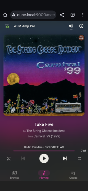

You probably need to install the ancient upnp/DLNA media interface plugin in LMS. Why not just use the LMS user interface, it is far superior to the WiiM Home App?
Typically you’d use something like the LMS/Lyrion Material Skin plugin or a suitable Lyrion app to play from Lyrion to a WiiM device. It’s not usual to use the WiiM app to access Lyrion as a server although there is an unsupported and very limited plugin which makes the Lyrion library look like a UPNP server to the WiiM app, but I wouldn’t bother with that and instead stick to the Material Skin interface
