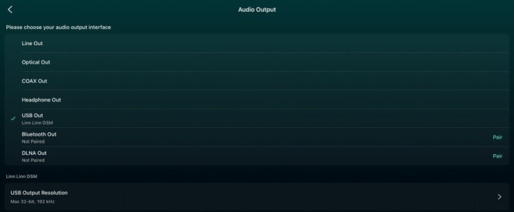

The Ultra can support up to 32/192 output resolution over USB, as per its settings
The specs say 24/192 for usb output. Not sure why the discrepancy. If it does 32 bit, then that means native DSD may be possible at least up to DSD128.
Don’t recall it officially being announced in a firmware update, but it’s there:
