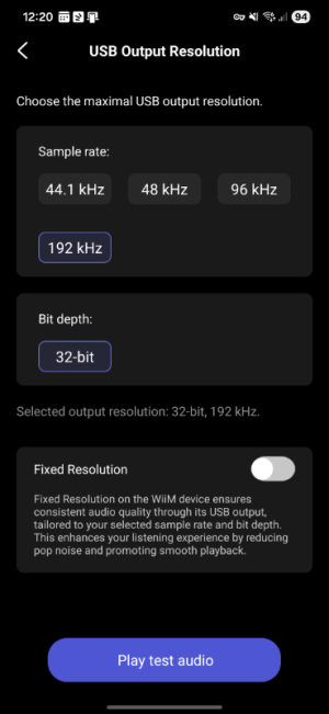

WiiM ultra can anyone tell me if you can select 16bit, 24bit, or 32bit bitrate when using usb out? I have been using usb out to my Berkeley Alpha USB version 2 and it has been working flawlessly for about 3 weeks. The Berkeley only handles bitrates up to max 24/192. If I look at the WiiM ultra usb out it recognizes it properly but only has the 32bit box and it is highlighted. I don’t have the option to select 16, or 24 bit. I am wondering if this is a software or hardware issue. Could anyone who is using USB out please check and see if you have the 3 selection boxes available.

I have done a reboot, and then a factory reset, still can’t get any other selection other than 32 bit to show up under usb out.

On my Topping D70 Pro I can only select 44.1 - 48 - 96 or 192 Sample rate and 32 bit depth. No other options even if the tech specs reports 16-32 bit support over USB.

The available options for bit depths and sample rate is what the attached USB device announces when handshaking with the WiiM. That is what is supported by the DAC/DDC attached.
The WiiM will adapt the output to this, with a max of 24/192.

Should it be "a max of 32/192"?

No. According to USB Audio Class definition the 24-bit supported by WiiM is left-justified in the 32-bit word (4 bytes) and least significant 8 bits of the 32 bits are zero-padded. The DAC will then ignore the 8 zero-padded bits and process only the 24 bits of each sample.

Oh. Was not aware. Make sense as it I assume works with any but depth, so just pad more zeros is source is 16bits. Clever.
But I assume would not work that way for files that have actual data encoded in 32bits, so if you have 32bit source (e.g. local files) it's just transferred as is.
Or I'm wrong.

As far as we know the WiiM will convert that to 24 bit but where that conversion happens in the stream (DSP, DAC) is not described. I don't think a 32 bit source will be output as 32 bit on the USB.
Any way, the are absolutely no need for 32 bit for the DAC. For studio mixing and for the DSP functionality using 32 bit is however normal.
