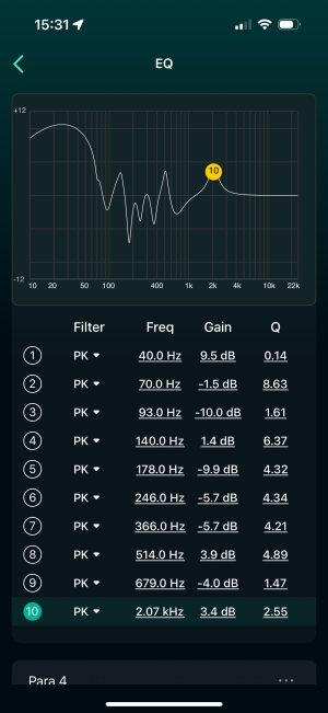

This post could have come from myself, I made exactly the same experience - played with the EQ before, then tried room correction and got a curve that I would never have created by myself. And it sounds better.
The result is better than I had with Dirac measurement with the NAD M10v2 btw.

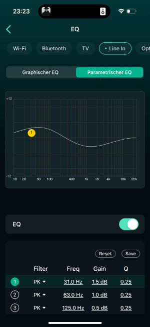

That was my manuel curve before I used room measurement:

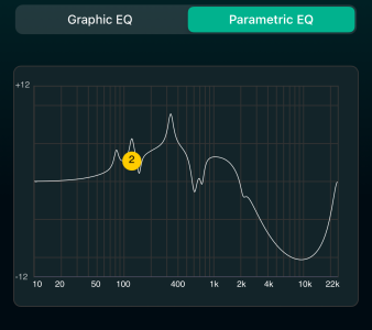

I need to figure out how to post a pic of my curve, but it's just about an inverse of your first one. My manual one had a bump around 1k
Interesting!! Do you have a room with little dampening that sounds bright? So that the Room Correction reduces the high frequencies?

It's a large room with high ceilings. Likely a lot of reflections I would guess. It doesn't sound bright to me, but I'm not sure if I can hear those frequencies anyway. Big dip at 10k and then back up.
That dip starts at 2kHz though. It must sound a lot different with and without EQ.

kinda insane though - +9.5dB in the 40Hz region? 🤯 do you have a subwoofer in your setup?
No, but interestingly I just compared the EQ setting from Room EQ with no EQ at all and the difference is only subtle. It sounds much better with EQ, but it’s only subtle changes that make it better.
It’s not that when I turn on EQ that I feel there is lots more bass. 93Hz is also -10db which might counter the +9,5db at 40Hz. I don’t really know.
It’s more that the sound gets more depth with the EQ turned on which sounds much better. It‘s really good what the WiiM has created for me.
fair enough, thanks for sharing your experience. maybe the EQ is just responding to your setup's lack of lower end? are you using floorstanders??
it's just that most songs these days with compression etc - they don't even have a dynamic range of 10 dB... many are around 5-7. so i dunno - it seems kinda insane to me to be modifying the source material to that extent by using EQ.
granted i'm not one of those anal "as the artist intended" people (cos what does that even mean? :LOL: ) but still. seems a bit excessive... 🤔
