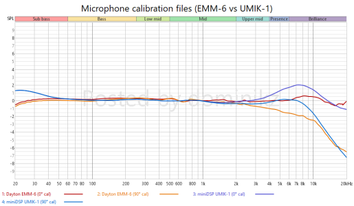

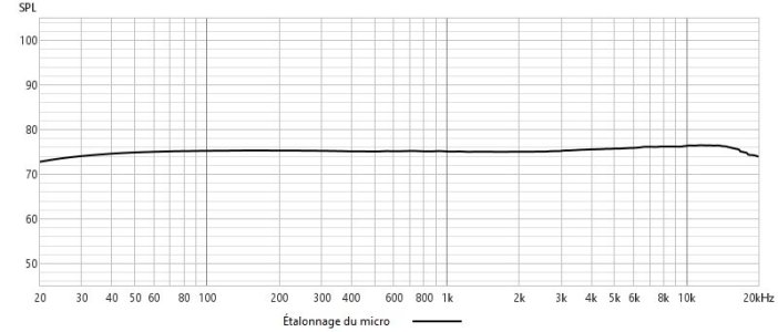

a dayton "cross spectrum" calibration ( your ""6khz"" down), no ?? ;-)
That it might, but given that the difference in response is 1-2dB at most (and mainly above 6kHz) I expect the difference in target level should be much less than 1dB.
examples to illustrate, a little, the classic situation:
cal "cross" ( in rew ) ;-)

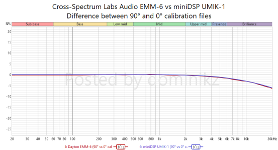

(end of cross spectrum, for those uses, general public, it was a really great offer, what a shame. :-( )
(on Earthworks , which normally does not provide 90-degree calibration, the drop is less pronounced but starts lower)
(The Umiks and the little Dayton USB remain great bargains suited to these uses... just be aware of their limitations depending on how you use them... ;-) )
