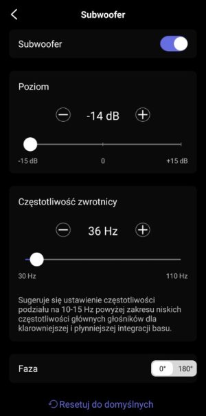

Hello... I have all the settings at minimum, but there's too much bass for me. Why is it only -15db? What should I change?
Several controls at your disposal:
Low pass frequency cutoff - is yours set too high? Change it down from 80Hz to 70, 60 and see if you hear a difference.
Sub gain - another parameter to use.
EQ of your main system - Set a high pass filter. Change those parameters and check.
What do you mean too much bass? If it's too loud reduce it.
If you find it boomy you'll need to look at room positioning , measuring and peq correction. You'll want to use a umik mic not a phone mic
You need to get them time aligned with the speakers as well.
Then you have to adjust subwoofer roll off this depends on your speakers and room. Typically good starting position is 80hz for speakers and 80hz but if your mains can go lower I'd recommend 60hz for both
What speakers do you have?
If ones in profile I'd probably use no lower than 60hz

Why would you set crossover to 36hz? Your speakers are incapable of that.
