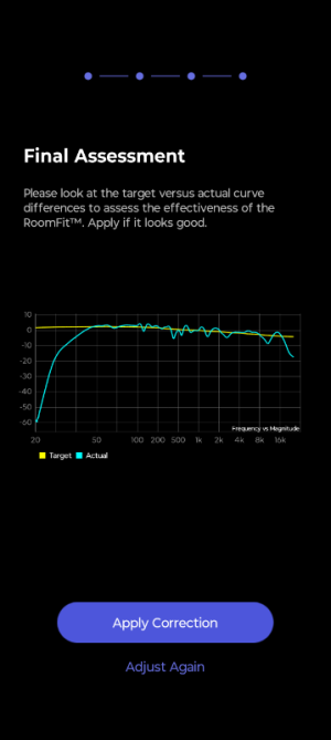

I seem to get different results most of the time i run room fit also depending on lower limit i choose for bass adjustmenets
Is that normal ?

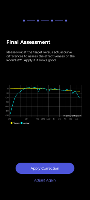

This is how it my frequency repsonce is -5 db at 40hz and -10d at 34-35 hz, -6db at 56hz was what some review measured my speakers to. 16-18 hz lower extention before it's down by -6db. Later i will try to se if i can get it to -5 db at 35hz or 30hz at -10db, that could be the limit of my compact 8" sub (150 watt) if still wanna play loud, lower extention then enhansing the bass so it's louder then everything else (it already feels very loud even when it's only flat down to 44-46 hz

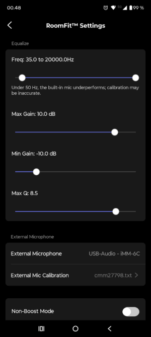

Well ... can you post a screenshot of the RoomFit process showing that the Dayton Audio mic is really used? Did you upload the calibration file?
Do we already know for sure the make and model of your old sub and your new sub and which one is in use right now?
yes i use the calibration file

Have it at 35hz limit but i guess i could try 30hz to se what result i would get

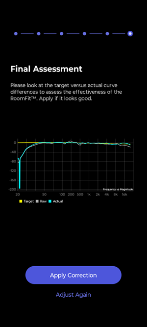

Why does the room corretion roomfit not shown the result the same way every time ?
I want it with 10 db intervals but atm it only does by 20 db Is there a way to change it, like zoom in and out and it's much more detailed with 1 db increments when you zoom in
Please tell me your smartphone model.
Is it a Xiaomi or Poco?
Motorola G86 Power
The Motorola G86 Power is a smartphone equipped with a MediaTek SoC, so I guess the IMM-6C microphone may not be able to pick up low frequencies.
Do you have any other smartphones or tablets?
These are my test results. The Xiaomi 13T Pro, which also uses a MediaTek SoC, showed abnormal readings in the low-frequency measurements.
