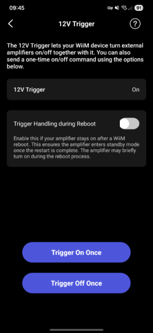

I noted a new option in WiiM Home on Android, that I'm now testing. Let see... I saw it not announced anywhere, did I just missed it?
"Trigger handling during reboot"
I see it on iOS too. I had no idea this feature existed. Thanks for mentioning it. I’ll give it a try and see how it goes.
