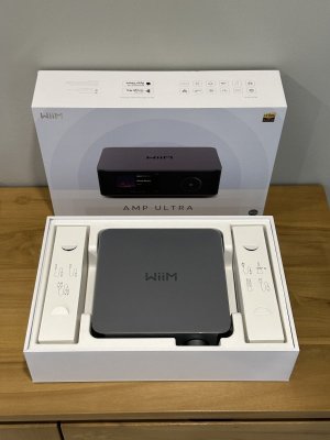

The Amp Ultra comes in a nice box with a handy remote control and all accessories included, where most other brands only include a powercord nowadays.
