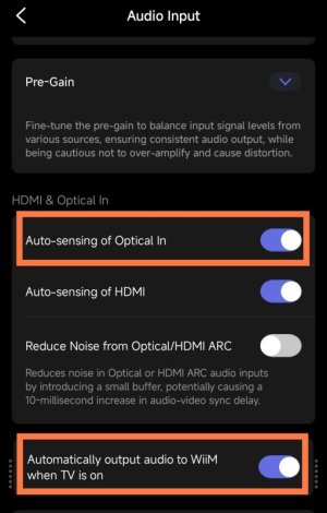

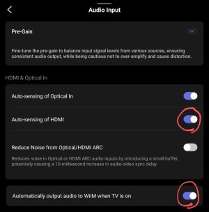

The above is how it behaves when these two toggles are switched on in the Audio Input settings.
If these two toggles are on, when using the WiiM TV app on a TV, it will work better if you first turn on the TV and open the WiiM TV app before playing music.
It will generally work the way you think it should. (Unless you need to use the TV speakers occasionally.)

I came bit late for the party but at @Wiimer are you sure that optical in should be marked in bracket on screenshot, not the hdmi one ?
BTW once optical and hdmi auto sensing do not work together (only one or another) does it make sens to have possibly to have both toggles of autosening „on” at the same time ? I guess there should be option to have either optical or hdmi enabled.
Thanks.
My mistake. I have corrected it 😅
