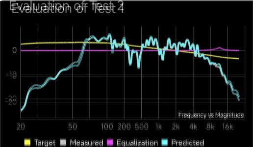

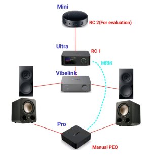

I'd use the total system lower bound frequency, which would include the sub as well.
Based on the screenshots you pasted that looks to be about 25Hz in-room?
Sorry for the lack of explanation.

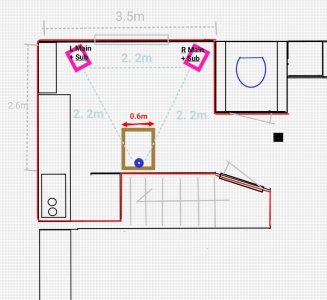

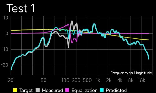

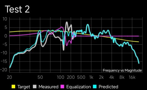

I have my main speakers connected to the Ultra and 2 subs connected to the Pro, so the RC on the Ultra cannot correct the full range including the subs. (The subs are adjusted by manual PEQ.)
This is my system.
My room is very small and oddly shaped.

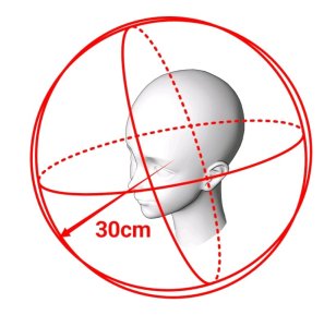

I am the only one who listens to music here, and I always sit on a 60 cm wide camping chair to listen.
This time I tried MMM on the main speakers with the subs turned off.
Two measurements were taken by moving the microphone erratically within a sphere of 30 cm radius from the tip of my nose.
First, the RC was run on Ultra.

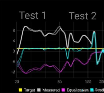

Frequency: 70hz-400hz
1/6 Octave
MMM on
[Test 1]
[Test 2]

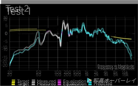

Next, only the grey measurements are compared.
Tests 1 and 2 overlaped. (Note the different widths of the Y-axis).
The results generally agree, but it is interesting to note that there is a difference of about 3 dB at 50hz.

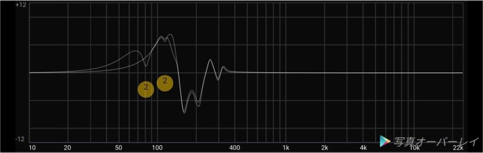

The PEQ values of tests 1 and 2 are then overlaped and compared.
Is this error acceptable?

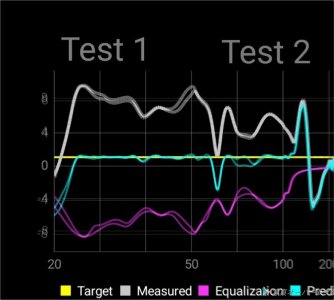

I was concerned about errors in the low frequencies, so I made MMM measurements of the 2 subs using Mini's RC.
The RC was run on Mini. (The microphone is fully fixed.)
Frequency: 25hz-120hz
1/12 Octave
MMM on
The RC is run twice and the results are overlaped.

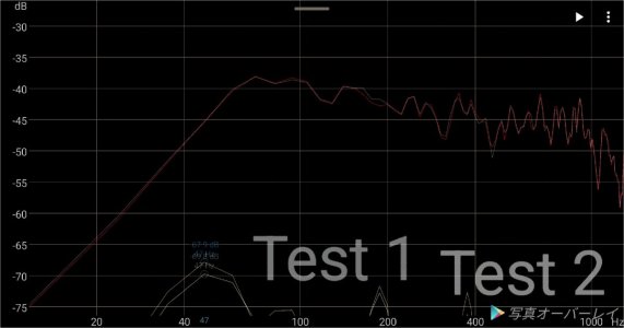

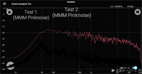

In case you are wondering, when the same measurements are made using other analyser apps, the results are almost identical.
The sound source used for the measurements is the WiiM RC's pink noise.
The results were measured twice on each of the 2 apps and the results were overlaped.
Note that MMM is much more sensitive to background noise compared to sweep method - that is actually one of the drawbacks of MMM. The analyser simply can't differentiate between measurement signal (periodic pink noise) and environment bacground noise.
So the 50Hz peak could be something like traffic noise, AC hum, refrigerator hum or something similar - which might explain the difference in level between takes.
Unfortunately the best solution is to use a healthy level when measuring, and to make sure you do it when there's limited or no background noise.
Otherwise the agreement between multiple takes/tests looks pretty good to me, great job!
This is my system.
1/6 Octave
MMM on
[Test 1]
[Test 2]
1/12 Octave
MMM on
Ah, that is a very satisfactory explanation.
I believe the 50hz background noise is caused by the fridge in the mini kitchen 😂.
I didn't think that would be an issue as the RC is loud enough... It's a very good learning experience.
Thank you very much! 😉
