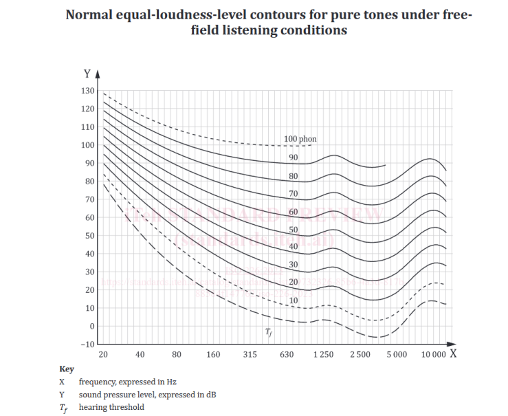

The bass level is the main difference between equal-loudness contours at different levels which is why many "loudness" functions only compensate bass.
To understand why, compare the ISO 226 80-phon equal-loudness curve with e.g. the 60-phon curve and you will see that the mid and high frequency shape is basically identical, but bass level is significantly different (image source):
Notice how the curves are much closer together in the bass region than they are in the mid and high frequencies (where the distances between curves are largely constant).
Note that the intention of a "loudness" function isn't to 'invert' the entire equal-loudness contour; it is to normalize the response to a reference curve - which largely boils down to just adjusting the level of bass.

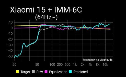

I guess it is a mechanism that does not correct for low frequencies approximately 10dB below the reference level.
This is the result of measuring the AudioPro A10 by connecting the IMM-6C mic to the Xiaomi 15.
IMM-6C can record down to 20Hz, but as the A10's bass drops sharply from 65Hz, RoomFit has corrected for frequencies down to 64Hz.

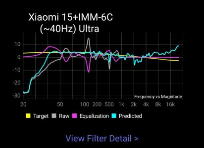

This is the result of measuring the Ultra (+ Focal Chora 806) using the same equipment. It was corrected down to 40Hz.

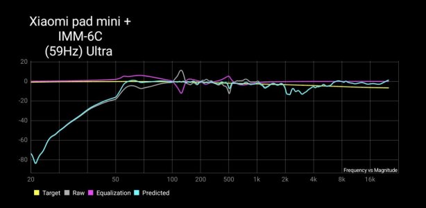

And this is the result of measuring Ultra on the Xiaomi Pad mini + IMM-6C. The Xiaomi Pad mini has an issue where it can't record low frequencies even when an external mic is connected. (This is the same issue already reported on some Xiaomi phones.)
Therefore, the sound recorded by the mic rolls off from 50Hz, and the correction only applies down to 59Hz.
At present, this automated function appears to be operating satisfactorily.
