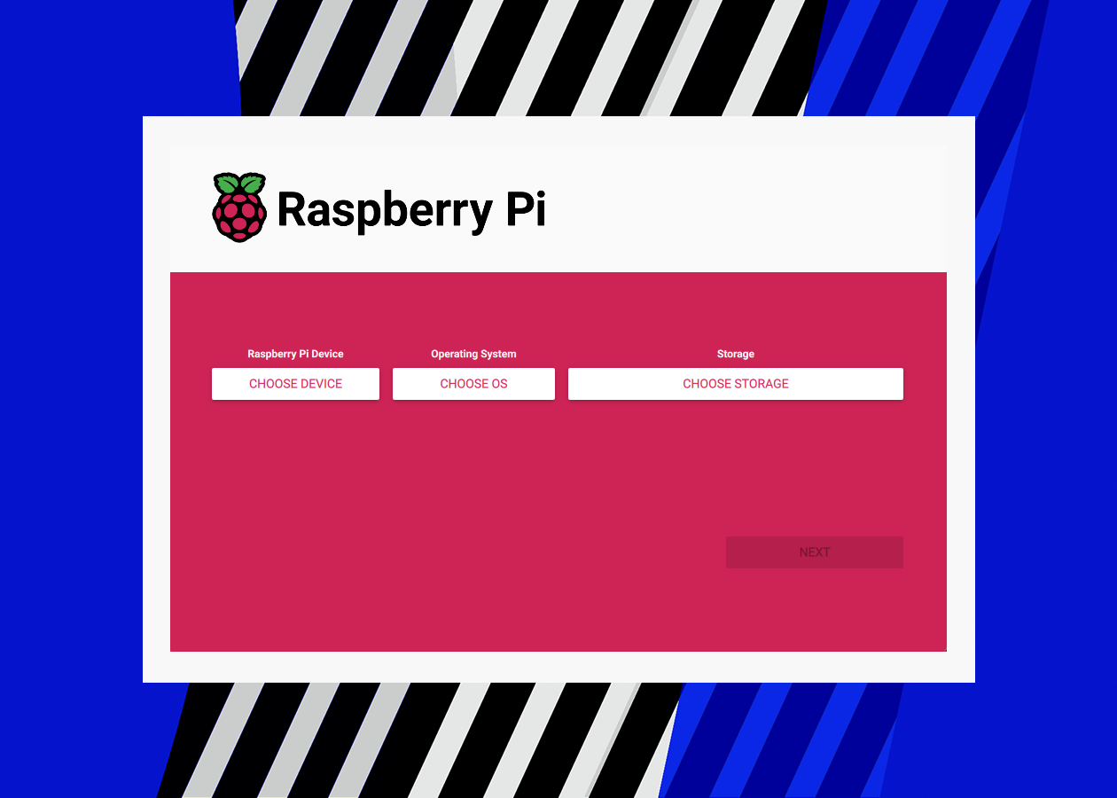

Ok, so you don't want to do the install right now?
The reason I ask is because the Pi 2 would require a 32 bit install whereas you could go 64 bit with the Pi 4. I just want to make sure I don't give you incorrect instructions.
Is that SD card just for the OS and server software, not for the music itself?
A beginners guide to installing an Operating System to your Raspberry Pi.
