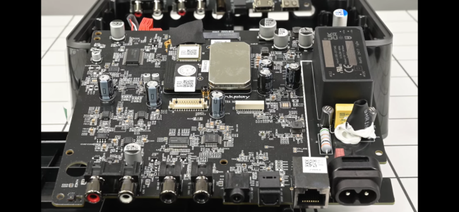

The main output uses ESSNice to see they used a Burr-Brown ADC, and the PS looks solid

Proposed sites for MFi circuits.Do I see a couple of unused spots for small chips?
My thought. I should have said unpopulated.Proposed sites for MFi circuits.
Or soldered on the reverse side of the PCB?My thought. I should have said unpopulated.
There’s a reverse view in the video. I can think of two reasons for unpopulated slots: one is to allow for premium versions of the board. The other is that some anticipated feature didn’t materialize.Or soldered on the reverse side of the PCB?
I don't see no spot there for whatever kind of chip.Take a guess…
There's a box, but the component labels are for resistors and capacitors. Where are you seeing an IC pad?Take a guess…
So what are they? I can't read them.No no, forget the missing chips, I zoomed in to better see what I believe are the analog stage opamps
