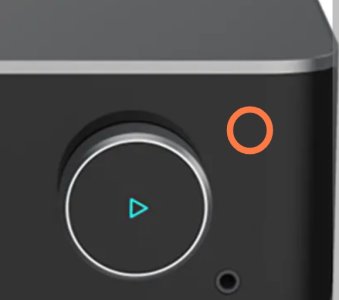

Also check that the illuminance sensor is clean. There is a small round sensor at the top right of the volume knob. (Block the sensor with your finger and check if the screen darkens.)
