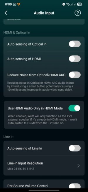

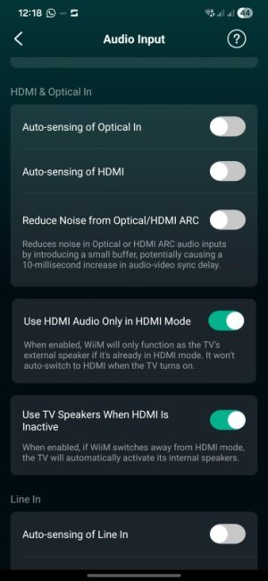

I usually don't turn the WiiM on when watching TV, unless I need it to play the TV sound.
Yeah, this part doesn't work for me. It does seem maddeningly close though, maybe my ticket will take it over the line.
I have once suggested "Active HDMI CEC control" but no one reacted to that.
Maybe a decent name -- if it also did what the beta description said it should -- would be "Always available for HDMI audio", with the meaning of the toggle flipped. Description something like "When disabled, WiiM will not function as the TV's external speaker when in standby or on a different input".
