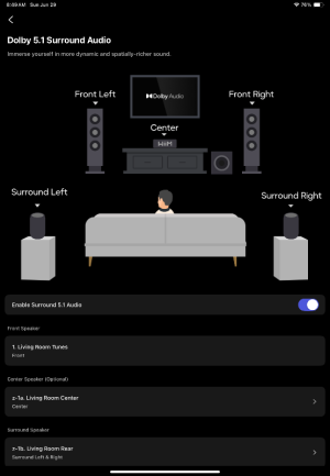

What does your Dolby setup screen look like?
I had no issues setting up 5.1 with an Ultra (front), a WiiM edition C10 (center) and an Amp (rear) once the firmware / app updates came.
I have had an issue where sometimes the app sets both the C10 and amp to surround left / right and does not assign a center, but that's infrequent and stays fixed when I change it back.
