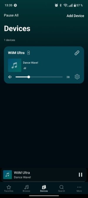

I have a question why after updating the firmware of my WiiM Vibelink Amp to version v1.2.714817 my device is no longer visible in the WiiM Home app, the Wiim Ultra device is visible. I tried unplugging the WiiM Vibelink Amp from the mains, restarting the router, restarting the phone, turning Bluetooth off and on, turning off the VPN and still nothing, the device is not visible. Please advise.

So I tried the factory settings, gave the amplifier time, but Vibelink did not appear in the app.You could try factory resetting your amp by holding in the power button for 5 seconds + until the indicator light on the front starts to flash. Then open the app and give the amp a bit of time and it should appear.
Yes Vibelink seems to be working, inputs can be switched, volume control also works and music plays.I presume the vibelink is still working ok though?

I didn't change anything, on Tuesday or Wednesday I was offered a Vibelink update.The update went well. After the update, the device appeared in Wiim Home, but could not be turned on or off, the Vibelink device said not connected, and then disappeared. Since then, it has not been visible.Have you changed the permissions on the WiiM home app?
