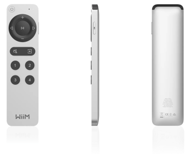

Presets 5-8 now available from the remote!
Mine are ver 32 and 39, but 32 did not work. I don't know how to update the remote 2 firmware...
Hmm, mine is version 41. I wonder how and when it updates. It very rarely gets used.
Please try re-pairing your remote and leaving the Amp on standby.
I connected a Remote 2 (ver 32) to Amp Ultra as a test, and 30 minutes later I looked at WHA and it had been updated to Ver 39 automatically. Double-clicking works fine.
This Remote 2 has been connected to Amp Pro since yesterday, but it didn't update automatically.
I assume from this result that perhaps the remote is auto updated by the firmware of the device?
I selected "Forget Remote" then re-paired it but I didn't need to put the remote into pairing mode, it connected automatically. Should I put it into pairing mode?
It is probably fine as it is.
But I don't know if it will be updated...
