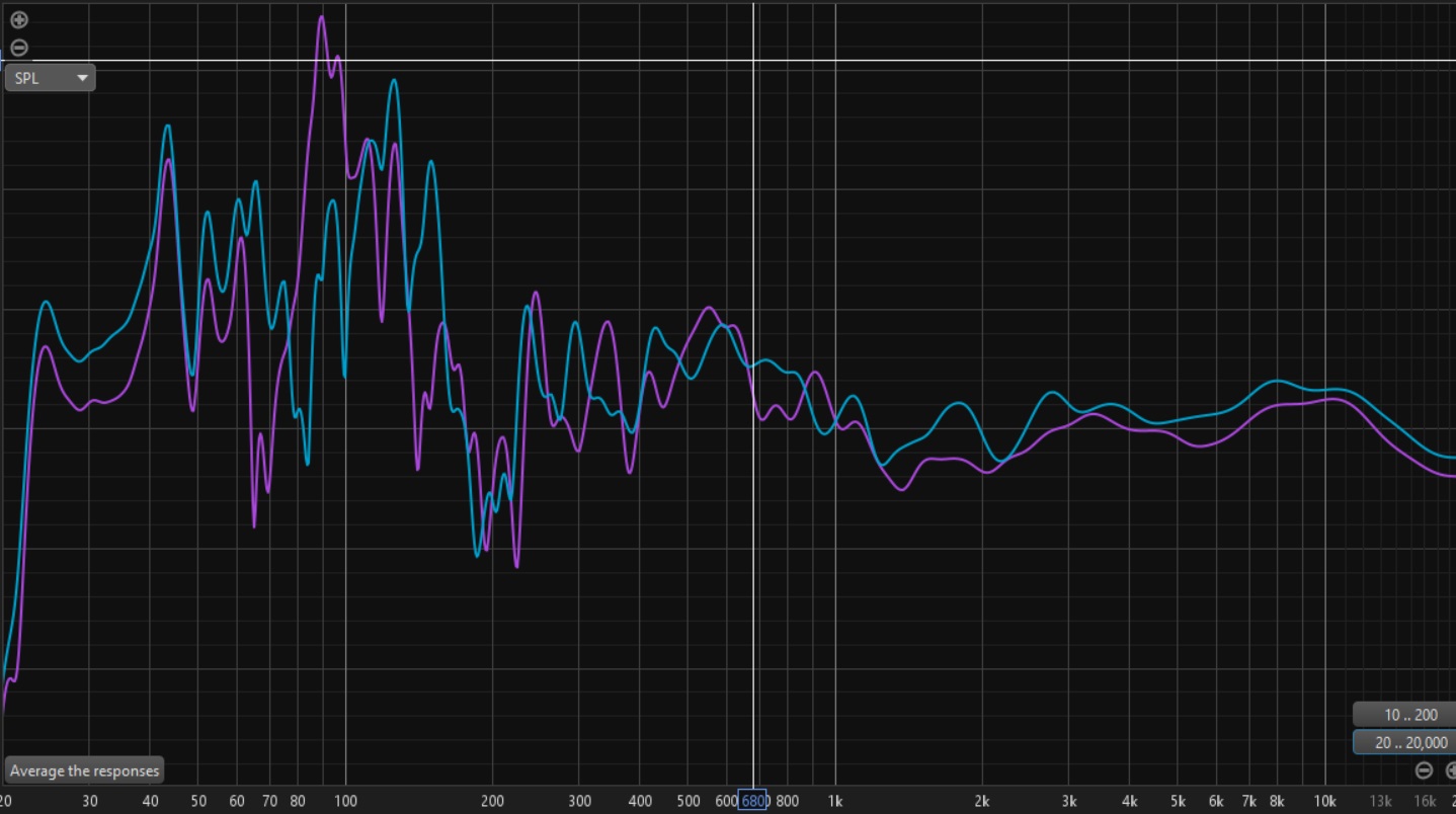

What is the moving microphone method?This is my latest attempt using the moving microphone method in REW. Red is uncorrected, green corrected. I corrected up to 10kHz.
Is this full sweep to 20khz instead limiting it to 10k on setting like wiim app?This is my latest attempt using the moving microphone method in REW. Red is uncorrected, green corrected. I corrected up to 10kHz.
A kind of the averaged measurement made in different positions and using a noise signal instead of the sweep.What is the moving microphone method?

I did *not* adjust my freq settings yet - I simply retested exactly as things were to get a comparison against the old not-so-great algorithm (50hz - 20khz, Harman Curve, Max again 6dB). In room response for my speakers (Focal Theva No1) is around 50hz, hence the seemingly arbitrary choice for low end).
As shown in the attached screen shots, MUCH improved gain choices and subjective listening was great - very solid bass response, near perfect sound staging. Verdict out on high end sparkle but that may be due to test music (Only Human by Rag n Bone, Proud by Welshly Arms) - no time right now to into some classical and see how instruments sound. Will do that tonight.
With the moving mic method you don't use a sweep. You play periodic pink noise while recording the result using the Real Time Analyser of Room EQ Wizard. It is meant to give similar results to using multiple sweeps with the microphone in different positions. It is surprising how repeatable the results are without being too concerned about microphone position.Is this full sweep to 20khz instead limiting it to 10k on setting like wiim app?
