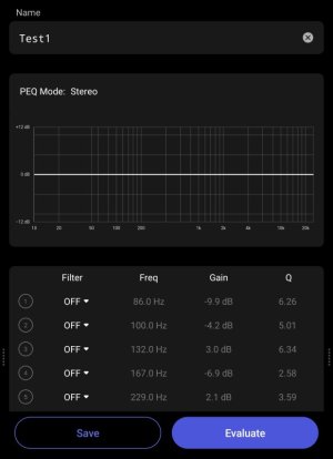

Have you checked your subwoofer's frequency response using RoomFit's evaluation function? I think you should set the lower limit to the frequency at which the bass rolls off.
Turn off the EQ and open a previously saved RoomFit profile.
After switching off all 10 bands, running the evaluation will allow you to see the subwoofer's response before correction.

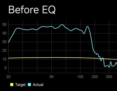

E.g., in my room, the sub rolls off from 25Hz, so I set the lower limit to 25Hz.
(This is the result of evaluating the sub alone after disconnecting the speaker cables.)

Your sub response is surprisingly flat with no sign of any room resonance. What was the crossover setting for that measurement?
This is the stereo measurement result for two subwoofers.
I guess the crossover was 125Hz, but as it's old data, I don't recall clearly.
(It may have been measured at 250Hz.)
