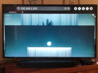

Just a quick update on using your suggestion to use the IP address from within the web browser of my LG TV to access the Raspberry Pi.
I did that and got a bit further and the "WiiM now playing" page was displayed in the LG TV browser.
However my LG TV wouldn't let me access the "Settings" dialog to select my WiiM Ultra device.
It seems that the LG TV browser doesn't allow the settings diaglog box to be created and displayed for some reason. :(
I've attached a picture below - see the little "finger" icon trying it's best to push the settings button! :LOL:
I'm not too bothered as I can still use my mini-PC to display the "WiiM now playing" stuff. :)
Just thought I'd report back to let you know.

Looking at your screen it doesn't seem that your LG TVs (default) browser does a very good job. Now the basic browser on Sony TVs doesn't either. So on a Sony TV you can use the 'TV Bro' app to properly render the Wnp app. I'm not familiar with the LG TVs app eco system and whether there is a proper replacement browser.
Let me check...
Edit: It doesn't seem that the LG TVs WebOS does not have an alternative browser as confirmed over here https://www.lg.com/ca_en/support/pr...JZw0fiIr9lSFugSNt20cmEi_i4809Zbv03UauAc5Oaf2j
Sorry :( The mini-pc route is the way to go for you. Or tinker some more and try and hookup the RPi's HDMI output to the TV.

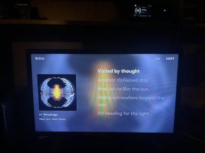

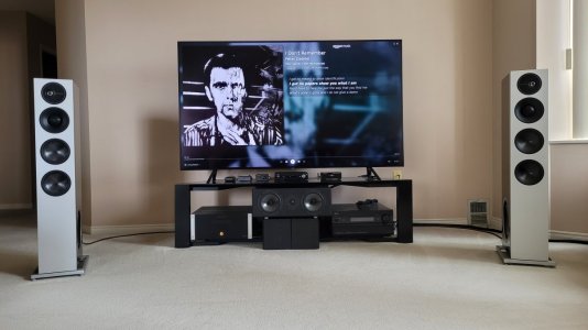

Yes, I had the WiiM Home TV app installed on a Chromecast with Google TV in anticipation before even picking up my WiiM Amp Ultra a few weeks ago.
I was a bit surprised that lyrics were implemented though. Excuse the poor picture - it looks better in real life. This is an old, small 26 inch TV and I can read it from across the room. The novelty has worn off a bit though so I usually only use it when listening to something new.
