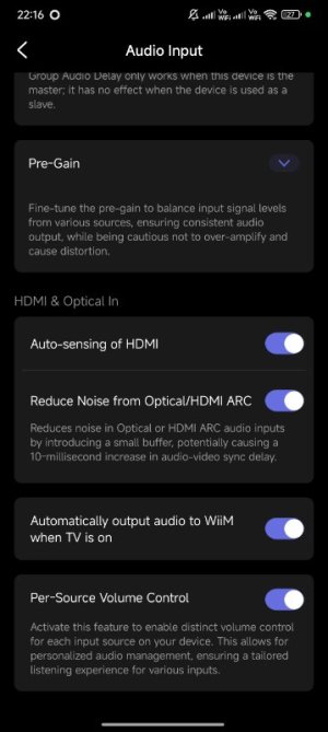

Note: my experience with the settings is as @Wiimer outlines
A brief test of ARC was carried out on an Amp Ultra to IFFALCON (TCL) TV. As long as I always used Ultra speakers, no problems occurred.
Auto-sensing : on
Automatically..... : on
Playing Spotify during TV playback switches to music, stopping the music switches back to TV. Switching on the TV while music is playing switches to HDMI.
Auto-sensing : on
Automatically..... : off
If I switch on the TV while music is playing, it does not switch to HDMI. If stop the music and play the TV, it switches to HDMI. I can use the WiiM TV app with this setting without any problems.
Auto-sensing : off
Stopping Spotify does not switch the input back to HDMI. Switching the TV off and on again will switch to HDMI.
The Automatically TV is on toggle on the WHA is greyed out.
Auto-sensing : off
The input never switches to HDMI.
In either mode, sound will come from the TV speakers if the TV is switched to the built-in speakers.
There is no ARC audio delay.
#This is a short test. It may be that...
I may have missed something somewhere.

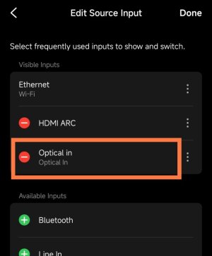

Just got the update
It is strange that I do not have auto sensing of optical setting
Optical is not connected, but option was present earlier as combined for optical/HDMI

Thanks for your help, I did a factory reset eventually.
I then tried what I did before, playing music and the ultra switched to HDMI on its own after about 5 minutes again
I went into settings and both autosense and automatically output to wiim toggles were on.
I turned off the automatically output toggle and just left autosense on.
The Ultra now works as it did before the update, it turns on to HDMI input when I turn on my TV.
And it doesn't switch to HDMI randomly when I play music. Hopefully it is OK now, only time will tell.
