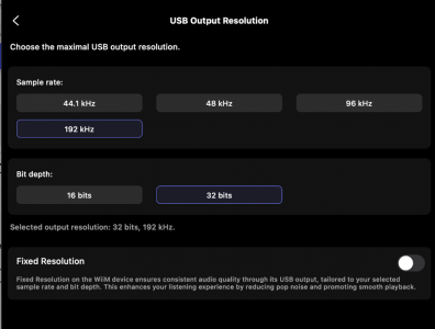

Also, on the Wiim if you choose to go USB you get 32bit audio vs the 24bit available on COAX this is a FACT, now I don't care what you could say about human hearing range it's simply more bandwidth!!!!!
So USB is better than COAX all things being equal! Take care!
The WiiM devices only support up to 24 bits, so even when the DAC support 32 bits on the USB interface, it will still be 24 bit dynamic range.

On your statement re USB at 32bit audio are you sure? I'm not an expert at all, but WiiM's documentation explicitly states "up to 24-bit/192 kHz" for digital outputs including USB, coax, and optical...
Pat, if you choose to wear high heels on the weekend it's Saturday and thats entirely up to you! Each to their own! See screenshot! Take care!

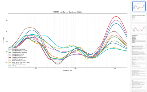

Btw, I produced some very cool PEQs for my Wiim and after a pretty in-depth room correction exercise using a mic & the house curve app which corrected the room both physically re speaker placement etc and digitally. The results are pretty amazing, here is a screenshot of the Master Reference graph of my PEQ project, which I made for my Wiim Ultra (I also own a Wiim Pro Plus - which I improved it sound with an iFi 5v Linear Power Supply but appreciate people on this forum who haven't tried it will call it snake oil because thats what they do around these parts!). I could tell you all about my findings of the Wiim's room correction. But, I realise you guys are such experts that you think cables don't make a difference and would hound me out of here! Shame as sometimes people who don't post as much on forums and don't have 'major contributor' titles under their names do actually have something to offer and most certainly if they say things like USB offers 32bit vs COAX 24bit then in fact it could be because they have been into the Wiim menus and seen/used it for themselves. Because as it turns out I was correct about both USB allowing the external dac full control of data retrieval vs Coax (24bit) allowing just receipt and it being able to go up to 32bit. I really have alot to offer but having had this experience with all of you, I won't my waste my time or energy which is a shame as I would've loved to help fellow audio enthusiasts level up their listening experience because I have very definitely upped mine for relatively nothing cost wise re corrections and PEQs without the need for pre-gain using both room correction and the PEQs in tandem. So let this be a lesson to you when other people come on to share information, that they maybe more experienced than you think, have tried out things you likely haven't and have listened to differences with their own ears! Take care all and hope you have learn a lesson from this!!!

Also, you were wrong here 'The WiiM devices only support up to 24 bits, so even when the DAC support 32 bits on the USB interface, it will still be 24 bit dynamic range.' - see attached screenshot, clears says 32bit output!!! I have done this myself via Audirvana (on my server) via Wiim!!! I am fast getting the impression that people who reply to posts on here don't actually try out the things they comment on for themselves!!
