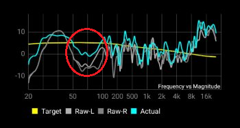

What @harkpabst is saying that with optimized phase and delay settings the -20dB setting might end up looking significantly better that it looks now.
With your current settings the -10dB result is definitely smoother after RoomFit (but it has a huge 40Hz resonance before RoomFit).

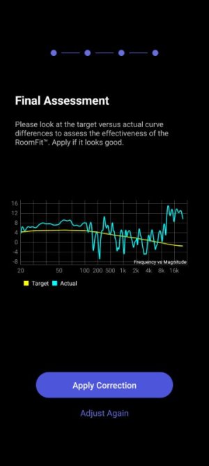

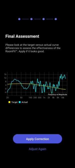

I'm not seeing that with the -10dB? I can it with the -20dB (which is the first graph) unless I'm misinterpreting?
Both of the last two graphs are after RoomFit, while my comment was referring to your previous measurements that contained both pre- and post-RoomFit screenshots for both subwoofer levels, e.g. this one is with -10dB I believe:
screenshot_20251113-140344-jpg.29360
The grey lines show the resonance at 40Hz prior RoomFit, which is fixed after RoomFit applied the correction (light blue line).
What I'm seeing with the -10dB graph is that RoomFit has smoothed out the frequency curve upto 100Hz ... but in doing so has used all 10 PEQ filters and had basically nothing left from 100Hz to 300Hz. Don't forget in the sub setup I specified the range as being from 20Hz to 300Hz.
