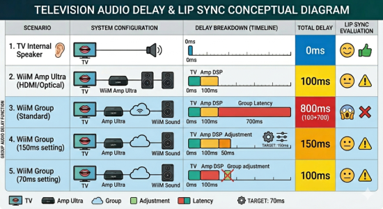

Since audio latency increases during group playback, I recommend opening the "Group Audio Latency" section in Ultra and setting the HDMI latency to 70ms or 150ms. (In the WiiM app, tap the gear icon in Ultra, open "Audio Input," and you'll find "Group Audio Latency.")
However, currently, automatic switching between 2ch and 4ch modes is not available. If you want to listen to music in 2ch mode, you will need to manually disable the group. Or, leave it set to 4ch and mute WiiM Sounds.
Sorry to pop back into this older thread - how does this help any potential lip sync issues with the tv? Given the tv will show the video and pass the audio to the WiiM device it's connected to and that then distributes the audio to the other speakers in the group which takes say x ms to do, how can a group delay help? Surely it would have to be an illogical negative value for it to sync with the audio. I would have thought that lip sync would need to be treated at source on the tv i.e. send the audio and delay the video by x ms?
I have a TV optical out feeding one of my pros.
By setting the 'optical in' group delay to 70ms the lip sync becomes bearable.
But you are quite right (obviously!) - video delay is the only ideal solution.
Yes, @Mr Ee wakes up earlier than I do.
If I'm at 800 ms, he is at 70 ms.😄
I had Gemini create an explanatory diagram of group audio delay.
(Since the latency for Ultra and Pro streamers is approximately 50 ms, the total delay for "2" and "5" is further reduced.)
