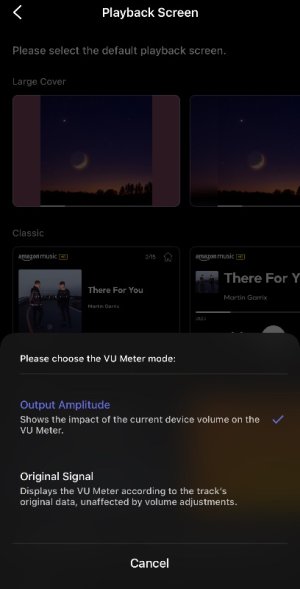

Is the VU-Output Amplitude completely broken for anyone else after the latest update?
I understand that it doesn’t serve a functional purpose beyond being visually appealing, but in previous versions, it loosely corresponded with volume levels. Now, the dial barely moves, even at high volumes!

Hi Team,
We’re actively working on a fix for this issue. In the meantime, please select the Original Signal option for reliable performance. For Output Amplitude, we’ll adjust the minimum threshold from –25 dB to –60 dB in the next update, as the current value is too low. The VU algorithm is already calculating the true RMS value. Thanks for your patience—we’re committed to resolving this quickly and ensuring the best experience.

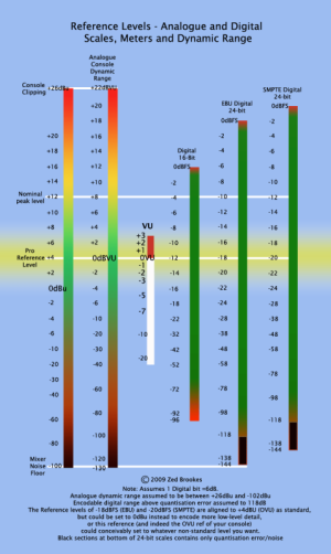

True RMS is for analog measurement, so unless the VU meter is measuring the analog output of the DAC, that is the wrong value.
The RMS dB is a relatively value, while the digital dBFS is absolute and just a logarithmic representation of the sample volume value.

So why not make it serious? It's not hard to do. And then the last 3% would be happy too.
If people want to keep the analog scale it's also not a problem. Both scales can be included and there are good conversion tables.
This is not exact mapping as the dB is relative but can be used nicely as long as the max is 0 dBFS (all bits are 1).
