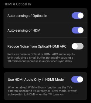

Honestly I’ll go even further - regular users like me need only auto sensing only when WiiM is in standby. If it is ON WiiM will wakes up once HDMI signal is detected. If HDMI ARC is not chosen I see no reason why the TV should route the signal to WiiM. Also, if I listen to music and my kid powers on the TV I definitely don’t want WiiM to switch to HDMI even if auto sense is enabled ( so auto sense works only when WiiM is in standby mode). Of course this is my personal opinion and many people can find having different options useful!
The issue here is that HDMI auto-sensing can only work if the TV has already directed its audio to the ARC output and that mean you don't have the TV using its internal speakers. Only when the TV can't "see" the WiiM (via CEC discovery) the TV will play on internal speakers else it will switch.

I’m not sure where that toggle is, but since I mainly use my Amp Pro for watching TV, this is how it’s set up.

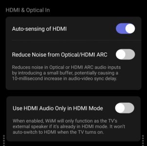

I mainly use the Amp Ultra for music, but since I use the WiiM TV app on my TV, this is how it’s set up. If I switch from the WiiM TV app to the YouTube app while music is playing, the WiiM automatically switches to HDMI.
"Auto switch HDMI ARC" ON/OFF is not an existing option, it's use cases.
Except you don't show the latest added HDMI option, your use cases are the same as I descibe, as far as I can see. The auto-sensing has no functionality when "Use HDMI Audio Only in HDMI Mode" is enabled anyway.

Try to disable "Use TV speakers when HDMI is inactive" and you will see how strange the HDMI input behaves.
I don't have time to try it right now, but you guys need to turn that toggle on, right? I mean, isn't that toggle there because it doesn't work properly when it's off? 🤪
The thing is that I cannot find any use cases for it being off. So why is it introduced?
Anyway the two use cases I described in #119 is all I need and they work with the settings shown.
I seem to recall that it was because "Use HDMI Audio Only in HDMI Mode" didn't work properly for you guys...
Doesn't that mean you couldn't resolve the issue without an additional toggle?🤔

I want that setting off!
HDMI from an Apple TV 4K is my primary everyday input. I only use that AVT4K while listening to music through the WiiM Ultra and its speaker group. When I occassionally play a file or stream using the Ultra rather than the ATV4K/AirPlay/Apple ecosystem, the WiiM switches to Ethernet mode - at this point, I most definitely DO NOT want my TV to give up on its HDMI ARC connection and setting. When next I initiate a new selection on the ATV4K, I don't want to hear anything from my damn LG monitor, I want the WiiM Ultra to perform its "Auto-sensing of HDMI" like I told it to, SWITCH to the HDMI input without bothering me, and play the music.

So I figured I should at least try turning on the "Use HDMI Audio Only in HDMI Mode" switch to see what it does. I'm still confused.
With it on, I paused the stream playing from the ATV4K and used the WiiM Ultra screen to start streaming a Pandora station. Worked fine - I'm listening to Pandora via the WiiM Ultra. I resume the ATV4K/HDMI ARC stream... it's ignored. I pause the Ultra's playback and pause/resume the ATV4K stream, and the Ultra switched back to HDMI and resumed playing the ARC stream. OK. The function DID behave as advertised and keep playing a WiiM-sourced stream when turning ON the ATV4K, but again, wouldn't turning OFF the "Auto-sensing of HDMI" have gotten the same result?
