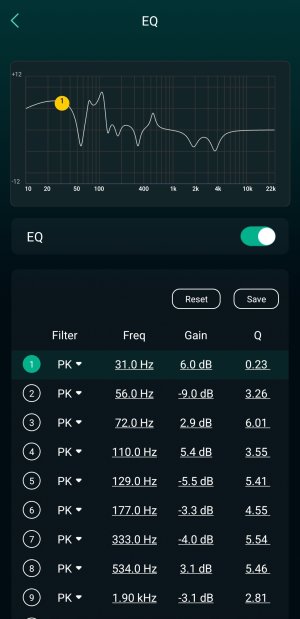

I have a similar room to you and just started playing with RC without much knowledge of how it works or what to expect. My second attempt with full range frequency and my iPad Air 2 produced this which sounds better than without EQ but I would like to understand it in more detail.

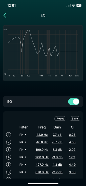

My chart goes into the same direction. Also I have the impression it sounds better / fuller… Tough the base department sounds a bit „overloaded“? Difficult to tell right now… And I assume the correction curve should be different with different volumes as modes become different(?)…
As far as I understand it, it does not always make sense to correct over the entire frequency spectrum. It is better to leave out the high frequencies. But where do high frequencies start?
Also, high "Q" values can apparently lead to distortion (I read this in another thread). Should you be more careful here and choose lower values for "Q"? What would be a good start?
I started to adjust the peak corrections, because they were too much… I did not understand the q values so far so I left them… 😅 I assume it is kind of the „steepness“ of the correction. The higher the value the narrower the band filter(?).

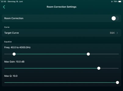

The standard frequency band is by default 40Hz to 4 kHz… sounds sensible to me.
More than 12dB boost at 100Hz is very likely to cause clipping and would explain it sounding overloaded.
Yeah, totally agree. I manually corrected it down. However, if I do 3 measurements on the same place (+/- 15cm) I get 3 different results +/- 5db. So to me it seams this „toy“ is too sensitive. It should be filtered a bit…

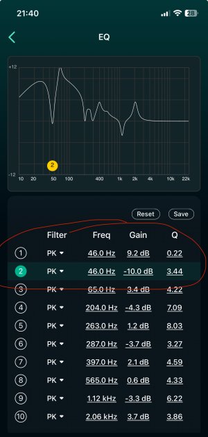

This I find particularly interesting… 🙄
See in red…
Remark: I used the standard settings (limited to +10)
See in red…
Nothing wrong with that, at least in theory. There's a very, very broad peak centered around 46 Hz, combined with a pretty narrow dip at 46 Hz.
Does it make sense? Is that iPad mic really good enough? I don't know.
Without knowing your speakers, your room, the target curve you selected and him much manual correction you applied it's impossible to tell if these results are good or bad on any way.
Nothin wrong with that, at least in theory. There's a very, very broad peak centered around 46 Hz, combined with a pretty narrow dip at 46 Hz.
The result sound bad!
Maybe the strange behaviour at 46Hz is due to the fact that default is 40Hz - 4kHz. This is the only way it could make sense - in theory. In practice the result is nonsense!

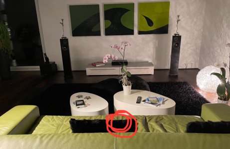

I did not apply any manual correction here.
The room is „cold“ - very little carpets, furniture etc. Big windows. 90m2.
Default target curve.
Speakers you see in the footer…
Red is the sweet spot position.
If the default is 40Hz to 4kHz and the target curve is Harman or similar it almost guarantees a large boost at low frequencies as the high frequencies can't be cut. A subwoofer helps since you can raise the gain of that to avoid having to boost the source.
