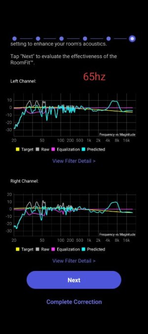

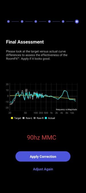

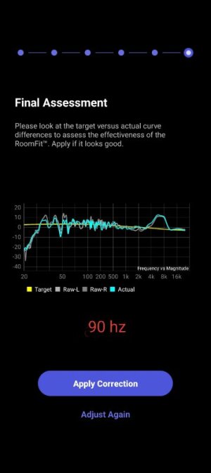

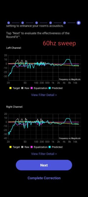

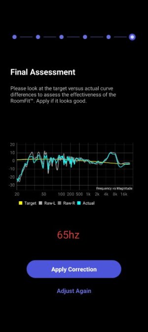

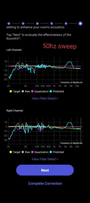

That looks correct to me, yes.I will try these next. Let me know if the right sequence of steps to do roomfit after crossover changes are as below:
1. Change crossover value
2. Keep the phase as same (180)
3. Run sub sync (auto) to set the delay
4. Run roomfit
Though you could also omit step 3 and just keep delay at 0ms or use the 3ms delay value which the auto function suggested.
