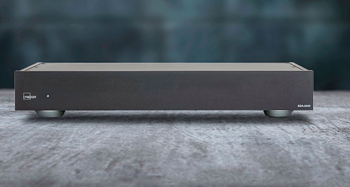

But I also love my Lyndorf SDA-2400. I believe it uses an earlier Purifi technologiy or maybe even a forerunner of it.
The SDA-2400 is rather the exact opposite of Purifi's technology. :). Like its Lyngdorf siblings, it's a "fully digital" class-D amp. Digital input, direct PCM to PWM conversion, no separate DAC, no global feedback.
All generations of Purifi modules are purely analogue class-D designs. High open loop gain, high feedback, digital sources must go through a DAC.
Ironically, Lyngdorf's design ultimately stems back from the TacT Millennium, developed by Lars Risbo. The same Lars Risbo sharing the CTO position with Bruno Putzeys at Purifi, which they co-founded with Peter Lyngdorf. :)
I‘m afraid you‘re wrong on this one.
The SDA is not a fully digital direct PCM to PWM amp. SDA stands for ‚semi digital amplifier‘.
It does have a DAC. The amp stage works in the analogue domain.
I don't find an hint into this direction. :unsure:
I had to go looking for it myself. The info provided by Lyngdorf is rather modest indeed.
I also had to do some more research and in the end the pure existence of the Burr-Brown PCM5102A is the real proof in the pudding, apart from all official (Equibit, Equilog) or unofficial (semi digital amplifier) marketing slang.
By all means, I agree, the SDA-2400 is obviously not a fully digital class-D amplifier.
I have a TDAi-2200 and this is fully digital (although I have the analog inputs option card). I had an SDA-2200?! and it was analog input and then digital all the way to the output, thus the semi-digital ;)
