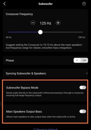

I have no experience with wireless subs or the Sub Pro, maybe some other folks can be of more help there. I’m surprised you don’t hear any difference when you disable the sub. You don’t want it to smack you in the face, but you should hear some difference. First, check your sub output settings and make sure both Subwoofer Bypass Mode and Main Speaker Output Bass are off. Those ensure that everything below your crossover point only goes to the sub, and everything above goes to the mains. The only other thing I can think to suggest is to play with the pre-gain settings (under the Audio Input), and see if lowering it 1 db at a time makes the sub more prominent.

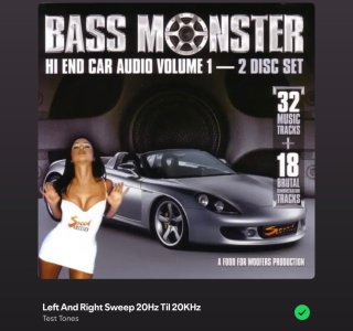

What audio source did you use to check?
Many streaming services offer audio files containing only bass frequencies, so please play these again to verify.
You can also play this sweep track to check whether the subwoofer and speaker volumes are matched.
I'm struggling today to find these toggles. Pretty sure I've seen them before but can't locate today.
"Subwoofer Bypass Mode and Main Speaker Output Bass are off"

I just use music audio and streaming TV audio. I'll try the audio you recommend.

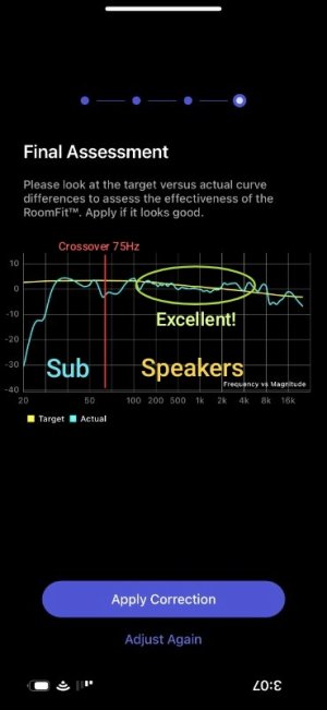

Not sure if these Room Fit files look good or not, but it's what I have.
Music and TV sound decent, but it's also a huge room with 18' ceilings.
You won’t be able to see them if your Sub Pro is paired to your WiiM device. You need to unpair your Sub Pro from your Amp Ultra using the Unpair option in the WiiM Sub Pro settings within the WiiM Home App.
Thank you for that information, I'll do that. It was driving me crazy since I remember seeing those screens in the past but couldn't find them anywhere today.

Could you please tap 'Evaluate' on the RoomFit profile edit screen and post your measurement results here?
The crossover is set to 75 currently.
I was inquiring about the subwoofer RoomFit. It seems to only put out low frequency which I hear, but I don't know if it is sub only or includes main speakers. I hear the whole sweep if I use RoomFit from the Amp.
I'll do an evaluate shortly.
When the sub plays the "sound" in preparation for evaluating RoomFit, there is plenty of base, so it must be in some of my settings that cause my perception of lacking base.
Currently the gain is +6 dB.
Thank you.
Where is the Sub pro positioned in your room? Placing the sub near the corner wall might enhance the bass.
Also, as there is a dip around 80Hz, it may be worth trying the following if possible.
Change the crossover to 100Hz (however, in this case, you may need to place the Sub pro in the centre of the speakers).
After turning the Sub volume up more, run RoomFit again.
You can also try the Harman curve in RoomFit.
Thank you.

How do my curves look in general? I have no experience interpreting them other than what sounds good to me.
The speaker response is excellent and flat above 150Hz, but there is a roll-off from 90Hz down to the crossover point (75Hz). I think increasing the sub volume and raising the crossover value could eliminate this dip. However, first try performing a full RoomFit Evaluation with the sub in its current position, using the following settings:
