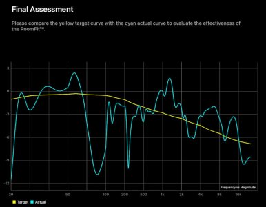

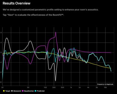

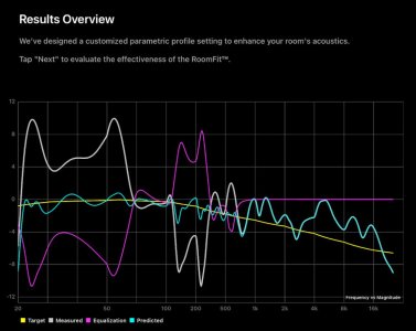

Are these two screenshots from the same RoomFit run? If so, then there's something extremely fishy.
Looking at the final assessment alone this looks ugly as hell, of course. But there is a big peak now around the crossover frequency where used to be a deep dip. This fact alone indicates to me that the inverted polarity is correct.

yes the screenshots were from the 180 run.

But the final assessment ist totally different from the prediction. That's odd.
Agreed; it's baffling.
