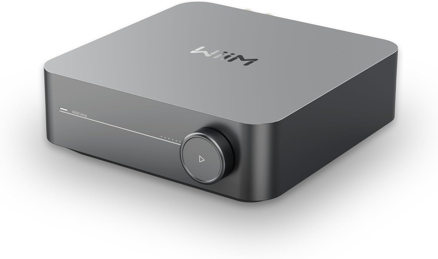

but a product, and the old models are not new and successful... the interest of peq for general public products is obvious...but arrives at the same time as the wiim a generation of dac chinoix proposing it... the "thing is launched" ;-)
the rc mode may be difficult to achieve but the wiim peq seems to be off to a good start now....
