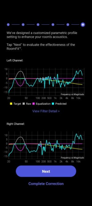

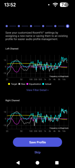

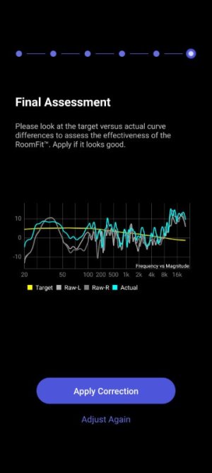

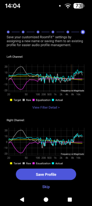

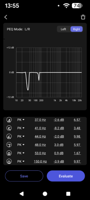

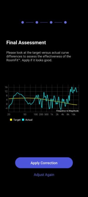

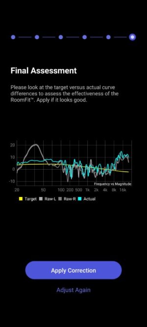

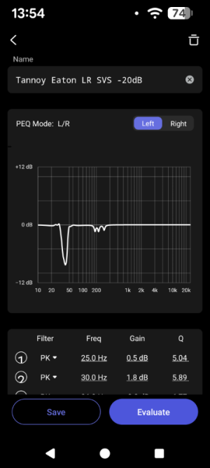

Thanks for this.I’d try maxing the volume at the sub - I saw that recommended for mine in a few different places - and control the bass level from the WiiM app. And I’d try pushing the crossover up to 80. Remember to set your sub gain in the WiiM app back to 0 before the next assessment, and don’t be surprised if you have to lower it further after a listen. The Tannoys may be rated down to 40 hz, but they’re working hard down there. The more lower frequencies you can push off to the sub (within reason) is that much extra work your mains don’t have to do, and the better they’ll sound handling mids and highs. 80 hz is well under your sub’s high end (240 hz, I believe), so that should be close to the sweet spot between sub and mains.
Just for reference, my Paradigms have a low frequency response of 53 hz. I started with the crossover at 80, then tried 120. While there wasn’t any discernible difference in the bass, the Paradigms seem a little happier being just that tad further away from their low end, so there at 120 it stays.

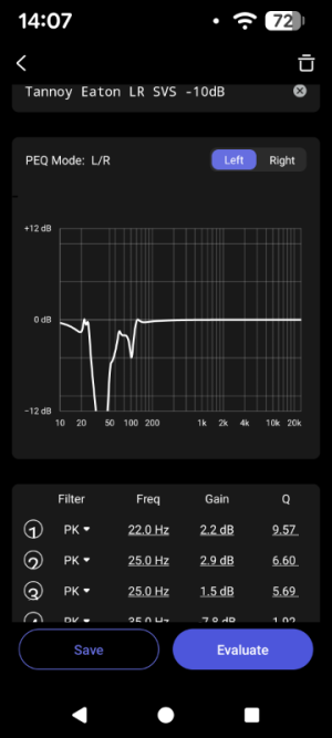

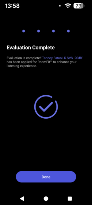

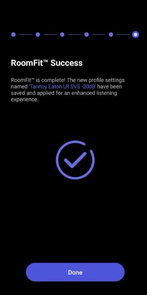

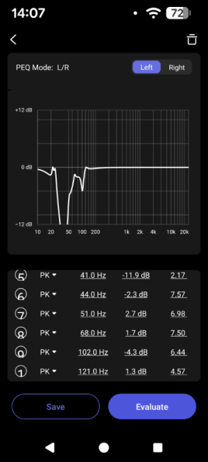

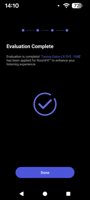

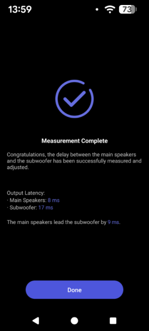

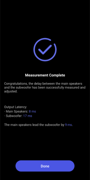

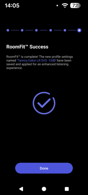

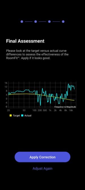

So am I right to say that I should set the SVS 3000 Micro volume back to 0dB instead of -30db and run the Sub and Main sync again?
Then in the WiiM app set the crossover at 80Hz and sub gain back to 0db and run RoomFit again?
