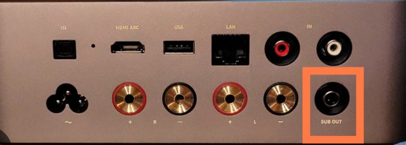

Thanks. One end to sub pro and other wiim amp ultra. What have i to check?

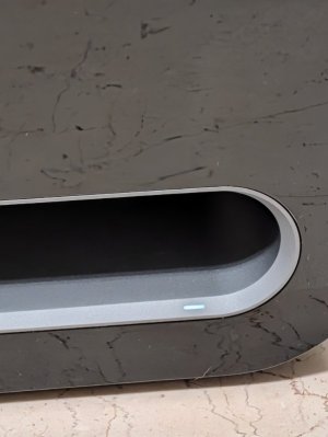

Did you pair the WiiM Sub Pro with the WiiM Amp Ultra yet (LED on the Sub Pro lights up continuously) or not (LED on the Sub Pro is flashing)? Pairing is not the same as connecting wirelessly.
When the devices are not paired yet, you will have to manually enable the sub out in the WiiM Amp Ultra's settings.
When the devices are paired, the WiiM Amp Ultra subwoofer settings are completely replaced with one common dialog for both devices.

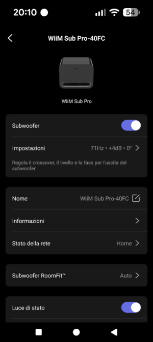

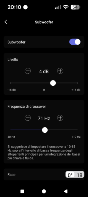

I thank you but i dont understand. I fid first startup sub pro and now led is white fix. In wiim application yet did not make any association because in subwoofer section of setting i see WIIMSUB name and it is selected. Can help?
Преместете плъзгача на Sub Out, за да го включите.
Стъпка 4: Активирайте изхода за субуфер​
Следвайте тези инструкции, за да активирате изхода за субуфер:
  1. Отворете приложението WiiM Home на мобилното си устройство.
  2. Отидете в раздела Устройства , докоснете иконата Настройки на устройството
    на вашия WiiM Amp или WiiM Amp Pro .
  3. Изберете „Субуфер“ и след това включете „Изход за субуфер“ , за да активирате изхода за субуфер.
Thanks but it is already actived
