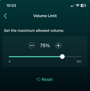

Hey all. Can this feature enhance sound quality? I ask because the volume control on these cheaper devices is often lacking. I’m trying it fixed now. Only, I needed to adjust the output level down as it’s too hot. Does this output level adjustment essentially keep the unit in preamp mode? If so then the point is moot I guess.

Okay. System is WiiM Ultra > Topping DAC (fixed output) > Rogue Sphinx. The combined output on my front end is too high to make the volume knob on my amplifier useful. I can put either the WiiM or the Topping DAC into preamp mode to cut the volume. I’d like to do whatever is cleanest.

This has nothing to do with the WiiM Ultra, it just puts out a full digital scale signal when the recording demands it. Changing the pre-gain, volume limiter or volume setting on the Ultra could all be used to mitigate the issue, but it's not the best solution.
