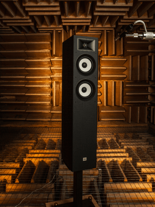

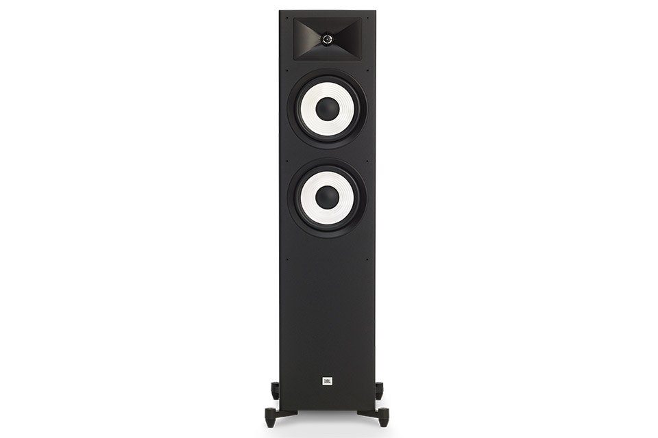

Maybe these
More or less around 1000 euros
